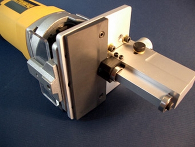

Tools to use: If you plan to build more then I would invest in binding fixture or a hand held binding attachment the indexes the side at two points. I have a stationary fixture and also this attachment for a hand held laminate trimmer
It indexes at two points as I said above, to keep the channels square to the sides. But then again I like hand routing over the stationary fixture.
